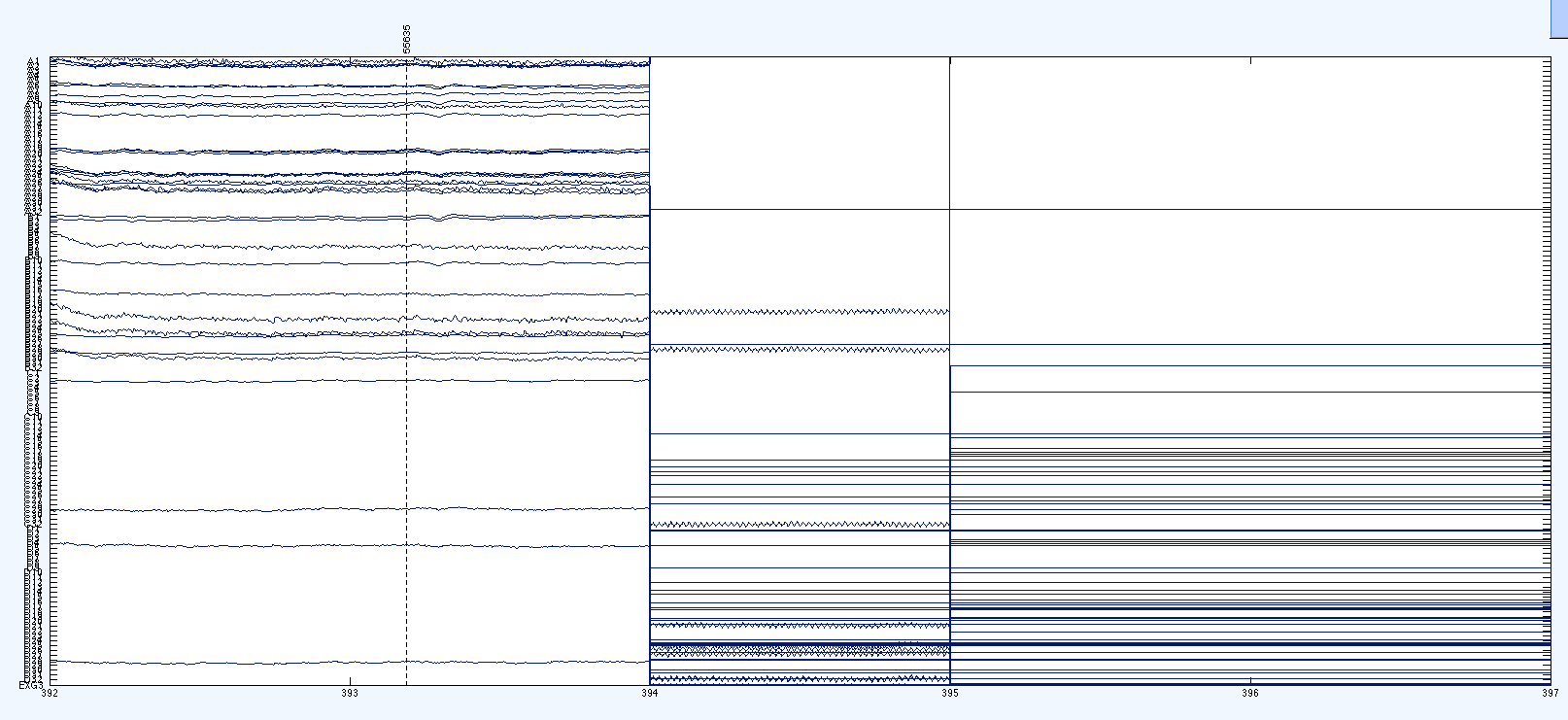

In a dataset recorded with a Biosemi ActiveTwo system (512 Hz, 128 electrodes), I find a loss of signal at some point, although the dataset has been recorded until the end. See a snapshot of the transition attached (visible whatever the software used). Nothing noticeable happened during the recording.
Does anyone have an idea of what might have happened ?

Streaming to file may have been paused/un-paused unintentionally by certain trigger codes, also see viewtopic.php?f=2&t=711&p=2174.
