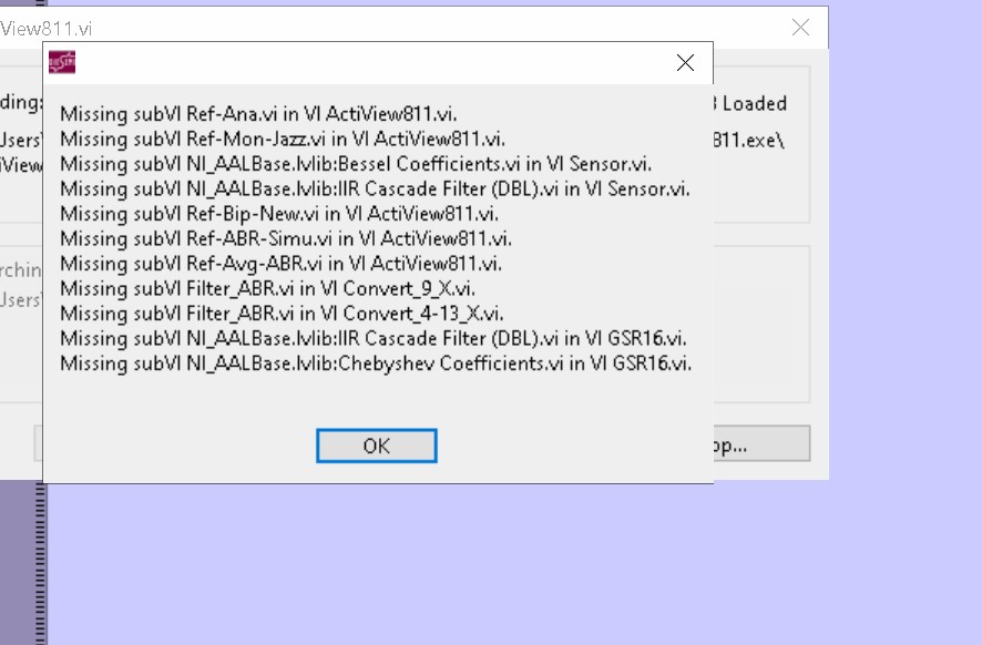

I just installed LabView Runtime Engine 16 to run the new ActiView 8.11..
I'm getting error messages:
Labview: Resource not found Ivanlys.dll
and all sorts or libraries connected..
Did anyone else get this message?? How do I resolve this??
Elli
Actiview Error Message.jpg (83.65 KiB) Viewed 82898 times

lvanlys.dll, lvinput.dll and RingBuffer.dll are in the zip download from our website. Make sure that these three dll's are in the same folder (or a subfolder) as the ActiView.exe.

All the libraries were in the ActiView folder... So a co-worker installed everything on her laptop, ActiView ran with no issues...
Turns out the issue was some security setting in Windows...
I switched to an older laptop now, no issues at all!
Thank you again!!
