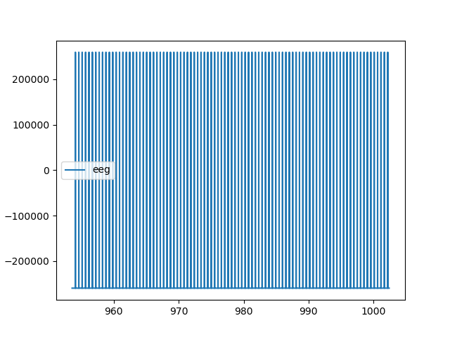

EEG_signal - a sample from one of the elektrodes, (time - microvolt). to clearify: the noise is apparent on all 64 electrodes used, so this is just a sample from one of them

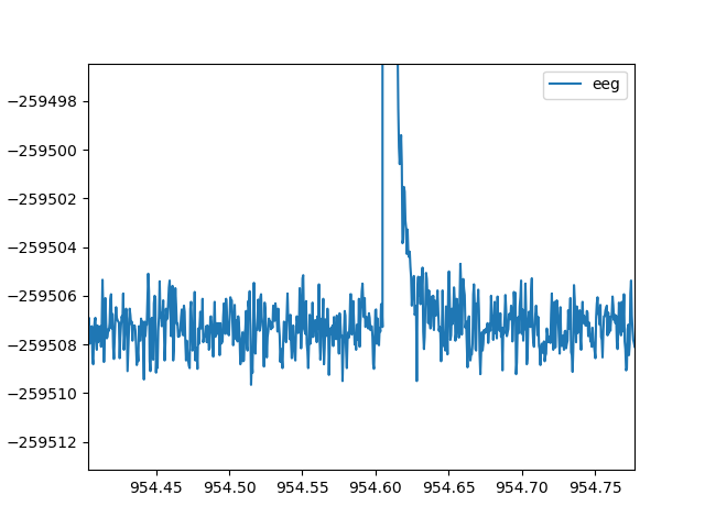

EEG_signal_zoom - zoomed version of EEG_signal, It seems to me that the correct eeg data excists in the signal(when you zoom in enough). Or am i completely off here, and this is just random noise from the equipment?

Re: Unknown(and unexcpected) noise
Blue light blinking ? Common Mode was not in range, confirm by checking the trigger/status channel in the BDF file. For solutions, see https://www.biosemi.com/faq/check_electrodes.htm . Data measured with blinking blue light is meaningless because power to the active electrodes is cut off.
